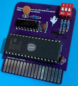

Message Publié : 10 Déc 2025, 09:31
Message(s) : 3568
Nouveau clone de cartouche CPC+/GX4000 sur PCBWAY : https://www.pcbway.com/project/sharepro ... 7c211.html
[...] The cartridge here resembles the dimensions of the original cartridge PCB and fits into a standard cartridge case. It can hold up to 8 games on a single EPROM (depending on the selected games and EPROM types).
Features:
- put up to 8 games on a single cartridge
- selection via dip switches
- same PCB size as original cartridges
- no ACID required
Full documentation regarding building and configuration can be found on Github: https://github.com/etomuc/gx4000-multi-cartridge
Tarif pour la France:
- Prix du PCB: €4.30
- Frais d’expédition (Global Direct Shipping) : €4.44 en 6-10 jours ouvrés
url/src: https://www.pcbway.com/project/sharepro ... 7c211.html ;linked:
