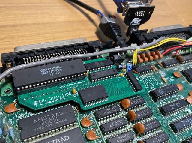

The 1MB iRAM internal RAM expansion for the CPC 6128 is finally finished and working.
It will be released on Github later this year.
Unlike the iRAM 640 it requires the SRAMs to be in SMD format, but they are quite easy to solder so it should still be DIY friendly
The very first expansion that I have built for documentation and testing purposes (basically the item #1) is now available on Ebay (starting at 1€) and I will ship to anywhere in the EU.
url's: ;linked:
https://github.com/etomuc/CPC6128_iRAM-640
https://www.ebay.fr/itm/267244725713

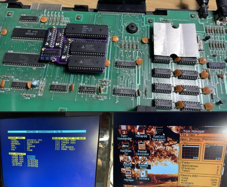

une version 464/664 en cours...
As promised, the internal 1MB RAM expansion iRAM/1024 for the CPC 464 and 664 is in development. The (hopefully) final prototype is in test now and so far everything works.
It gives you up to 1MB of total RAM and supports C3 mode (needed for some 6128 specific applications, games and demos like CP/M plus, Future OS or PacMan emulator).
As with the iRAM/640 for the 6128, it will be pure plug&play. Open the CPC, remove the CPU and put it into the socket on the iRAM. Then place the iRAM into the CPU socket on the motherboard. And voilà, enjoy up to 1MB of total RAM.
It will be still a few more weeks until the tests are finished. Once this is done it will be released on GitHub (for DIY projects) - and probably you can find it sooner or later on Ebay.

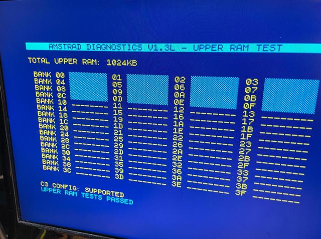

New internal 1024KB RAM expansion iRAM/1024 coming to the CPC 464/664 at the end of summer
The PCB has been refactored now so it will fit into all variants of the 464 and 664.
Full 6128 compatibility incl. C3 banking so FutureOS, CP/M plus and 6128 demos/games can properly work.
It's awesome to see a CPC 464 running SymbOS with a full 1MB of RAM being available :)
As usual it's DIY friendly, so all easy available, cheap through-hole components with long-term availability.
It will also be possible to build a 576K version (1 SRAM only, no C3 support) or a 640K version (second SRAM is 128K instead of 512K) with the same PCB and logic ICs.
There will be a few more weeks of testing before it will be officially released on Github but I'm very confident that everything works now.
