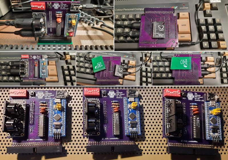

An Extension Board for the Amstrad CPC based on the Blue Pill Microcontroller
It's a generic IO interface to the CPC, so use cases are generic.
The Ultimate CPC MIDI Sound & MIDI Interface Card
The first application of this IO interface: using an S2 Waveblaster from Serdashop and an Adafruit Midifeather board to create the ultimate CPC MIDI sound + MIDI interface card.
Features:
  • CPC MIDI Soundcard using the S2 GM MIDI Module from Serdashop
  • CPC can send MIDI data over output port &FBEE to the S2
  • MIDI IN and MIDI OUT via Adadfruit Midifeather (standard MIDI DIN sockets)
  • MIDI IN to the CPC: check for new MIDI byte on input port &FBFE and fetch pending byte from buffer via &FBEE
  • MIDI soft through: all incoming MIDI data (from CPC or MIDI IN) can be forwarded / relayed to the MIDI OUT socket ("MIDI SOFT THRU")
  • CPC MIDI Synthesizer software in machine code (MIDI INPUT demo)
  • CPC GM Drumcomputer software in BASIC (MIDI OUTPUT demo)
    "Lazy engineering": MX4 compatible CPC extension board using three sockets, one for the Blue Pill, one for the S2, one for the optional Midifeather.
    Only one additional chip required - a GAL22V10 programmed as an address decoder. The Blue Bill does not have enough 5V-compatible GPIO ports to do the decoding fully in sofware
  • Everything else is done purely in software - unlike LampdaSpeak, no additional glue logic is required to manage the databus (e.g., no flip flop to latch the databus upon IOWRITE requests, or busdriver to tristate the microcontroller output to the bus upon IOREAD requests). The 72 MHz Blue Pill is fast enough to respond to and manage IO requests and the databus via ISRs (Interupt Service Routines). It was tedious to get the timing of the ISRs right (done by inserting __asm__("nop") at the right spots), but it works flawlessly by now.
  • No extra circuitry for Z80 /WAIT management
  • Low cost - final PCB will be in the 50 to 60 EUR range
  • Very DIY friendly (no SMD, plug and play of standard modules)
